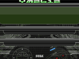

here is a quickly made background, you can add this if you want
link to background file 16 color 4bit .bmp >> http://www.alyjameslab.com/tempdata/FMe ... r_4bit.bmp

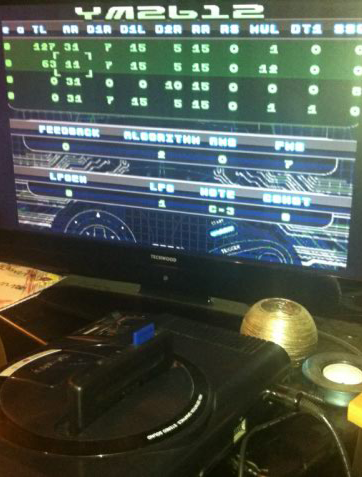

EDIT: Tested on hardware (with everdrive)
-early Model 1 non TMSS = display fine but do not respond to the controller pad or maybe crash internally.
-later Model TMSS = do not display fine, screen mostly filed with cursor tiles all around. do not work either
It should be related to your last v2 added code because the first version loads fine in Regen and Hardware

Wow, that background looks amazing! I'll get to work in integrating it right away.
Thank you very much for the test in hardware as well! I noticed that I'd done something that made Regen unhappy, but it worked in Fusion. A Regen crash usually means I've not balanced the stack correctly or somehow executed a bad 68000 instruction. Lots of work to do!
I've not yet been able to make rom that works on my own hardware (on my custom EEPROM pcb, not Everdrive). I've seen the 'screen is filled with [ tiles bug' on my PAL Mega Drive 1 when I wrote a simple test code that wrote some text tiles and used the D pad to scroll the screen. The logic, pad reading and scrolling worked, but the screen was filled with [. I'm still working on figuring that out, but it's slow going.
Edit - I'd missed out the .b on one of my instructions, meaning that the 68000 was trying to do a default word-sized access on an odd address. Bang.
This version has the background and won't crash in Regen.
http://www.mrdictionary.net/stuff/2014/ ... tmaker.zip
awesome, loads fine and works fine on MD1MrD wrote:This version has the background and won't crash in Regen.
If you need or want to improve this at some point, adding pages for CH3 special modes or csm and even CH6 PCM...let me know I will adapt backgrounds.
For now it will be useful to directly test a patch on the hardware without needing a special communication tool like GenMDM or GEMS.!
