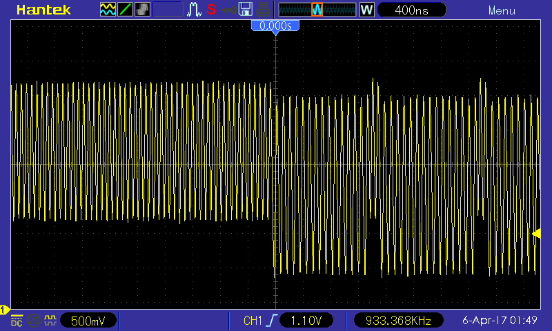

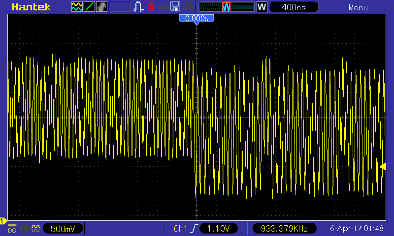

So here's some shots of EDClk, triggered as it switched to 10.6Mhz
On a regular cart:
On UMDK:

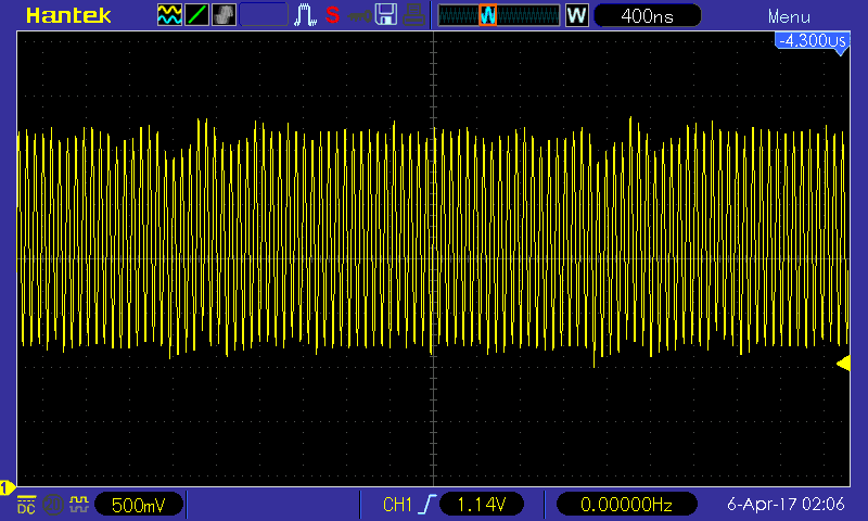

And if you look in this pic you can see clearly that there's a repeating pattern running through, which repeats at about 251Khz
The attached zip contains a few more captures at the same point
On a regular cart:
On UMDK:

What I can see here is that you're either loading the signal significantly or your equipment doesn't have enough bandwidth (or both).
As this clock signal is used by the VDP for video timings and DMA bus operations, when you probe it then the signal will have a slower edge delaying the DMA operations by a unspecified amount (since VDP, 68k and z80 are at play here, they need to resyncro themselves). The 68k releases the bus, and then DMA should start, although there may be a z80 access in there depending on the code.
In theory this should not affect the UMDK operation, but since it users are reporting various kinds of failures on the UMDK maybe it affects it somewhat (maybe it captures the access request too late, or doesn't capture it at all, or it's in the middle of a refresh. This is UMDK's business which I don't know how it handles things)
I don't think the 251kHz beating you're seeing on top of the EDClk is of any importance, obviosuly a higher power consuming device (specially dynamic power consuption) is gonna create bigger disturbances on the voltage rails, and consequently on the signals themselves compared to a regular cart that is just a mask rom. At any rate it's half of a vertical division so you're looking at 250mV of a peak. For instance my scope shows EDClk toggling from -0.6 to 5V normally (and I see half volt disturbances on top of it even when no cart is present).
