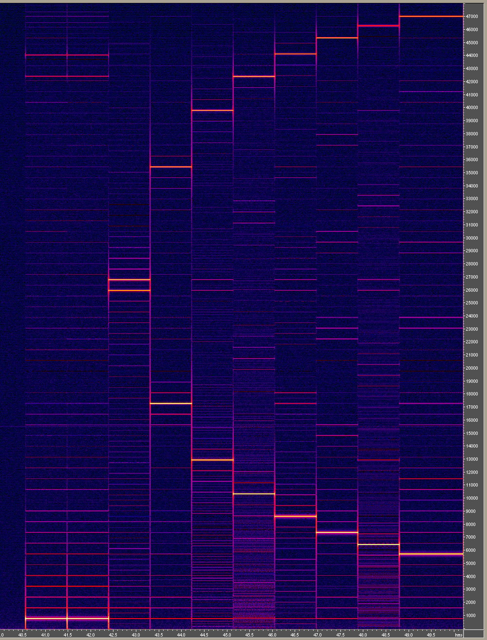

Here's spectrogram (Cool Edit 1, Blackman's algorithm, 2048 bands, Range 140 dB):
As you can see, notes 32 and 2016 (first two columns) are identical. All divisors give phantom of note 32 (825 Hz at the bottom of spectrogram), except 5 - it makes phantom of 33 (850 Hz).
And, starting from divisor 4 there is some sort of ladder steps proportionally between main and mirrored harmonics. Divisor 4 has 1 "pair of steps", divisor 5 has 2 "pairs", etc., last divisor (9) has 6 pairs.
Listening to HW we can hear the same note (excluding divisor 5) in various octaves - that prooves presenting of 825 Hz freq and its multiples.
