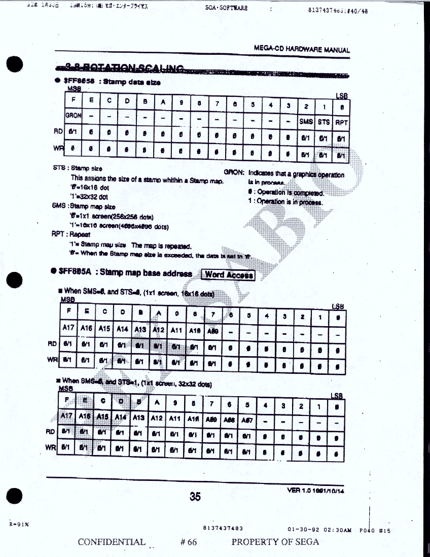

I see that GPGX is caching some stuff when starting a new block render
Yes, to optimize rendering, I precalculate all the parameters that remain unchanged and initialize address pointers when the gfx operation is triggered rather than recalculating or reading again everything on each line, assuming no software will try to modify ASIC registers on-the-fly during gfx operation.
Note that I also use some lookup tables (LUT) initialised in gfx_init to optimize some calculations (for the record, I was mostly inspirated by Charles MacDonald's VDP rendering code that heavily made use of LUTs for optimizing tiles rendering). This probably makes the gfx rendering code a little bit harder to follow but I generally tried to comment my code with as much details as possible.
An odd thing with GPGX is the initial bufferStart, which adds reg[0x60]&0x3f to it (the image offset) as a pixel displacement.
That is because bufferStart/bufferIndex is a pixel 'address' (written byte address = bufferIndex >> 1 ) to make processing easier (all width/offset register values are in pixels unit). Register ff8060 contains line offset (0-7) in bits 5:3 and pixel offset (0-7) in bits 2:0 for the image buffer start address but since base address (in register ff8058) is always aligned to the start of a 8x8 pixels cell and 8-pixels lines within a cell are arranged sequentially in memory, the 6-bit value in register ff8060 actually corresponds to pixel offset (0-63) from the base address.
Each tile is always 64 bytes, which is 16x16 pixels worth of data, seemingly unaffected by the stamp tile size bit.
No, each tile/cell in image buffer is 64 (8×8) pixels. As explained above, all calculations (including address and offset values) are treated in pixels unit.
I guess it's odd that it's ((bufferIndex&7)!=7) instead of something like
You have to keep in mind that, because of image buffer offset register, the image buffer start address can be anywhere in the virtual cell map and it is not necessarely aligned to the first of the eight pixels within a cell line so your proposed code would be incorrect in such case. In short, bufferStart (initial value of bufferIndex) & 7 is not always equal to 0, hence why this is coded like this.
I'm guessing this is another workaround to save a bit, and that the actual Main-CPU determines the end of a graphics transfer via the IRQ.
Well, not this time :wink:
Bit 15 is actually used to indicate gfx operation is in progress and cleared when it ends. For some reason, it's only documented in hardware manual but not software manual :roll:
See https://www.megadrive.org/elbarto/megac ... Cdh-35.gif
I am quite sure this bit is polled in some games instead of just using int1
But ... yeah, none of it explains my image result. It looks as if I'm rendering one line too many/too few, and that each other tile column is offset by one, but no matter which variables I tweak, nothing seems to improve either case. Fun.

Take a look at the full microcontroller code though, as in it you have a complete, known working implementation of the low-level drive behaviour, with comments to boot. If you're not sure what you should do to implement a particular command, just take a look and see what they did.
Now I haven't gone down the rabbit hole of attempting MegaCD emulation myself yet, and I've done little more than browse through the information I've come across, but I suspect with the Sega developer manuals, the Sega service manuals, and the LC8951 docs I expect you already have, combined with this information, that will cover a lot of the bases when it comes to the basics of the CD control hardware itself.

I should mention, I also know of two people who have a bunch of official docs, containing lots of technical bulletins that have never been scanned/released publicly before. I'm hoping to be able to get at least one of them to scan and share these documents at some point in the near future, as there could be valuable information contained in them that could help emulation. Also, I've spent some time working with the Pioneer LaserActive hardware, AKA, the "MegaLD" system. You'll be pleased to know that MegaLD hardware isn't that much of a stretch past the MegaCD itself, it's really just an extra set of hardware registers mapped in at another address, which I've mostly worked out already. If you get the MegaCD part solid, you'll be able to add support for the MegaLD system easily enough from there. Although getting complete good rips of the analog video is a work in progress, ripping the digital content is a solved problem. If you're making a serious push into this area, I'd recommend planning to go the whole way and support the MegaLD hardware.
EDIT: Here's a list of the MegaCD technical bulletins with descriptions that I currently know of, which we don't have:
#2 - The attached document contains information regarding use of backup RAM on the Sega-CD
#3 - The attached document is a supplement to the sega-cd manual and contains notes nd updates on a variety of subjects
#4 - contains updates on basic sample playback frequency for the Sega -CD PCM sound chip
#5 - waiting during Vram reading and also ap roblem with the Super Target Development Systems
#6 - problems encountered while using Macintosh Sound Designer to produce Redbook audio
#7 - New standards for Sega-CD ID table
#16 - additional cd software development guidelins as well as updates to the CD-ROM Manual
#17 - contains info of sega approved write-once writers and discs
#18 - swapping PRG-RAM (program RAM) into the Genesis side by halding the SUB CPU the method is unsafe and unstable
