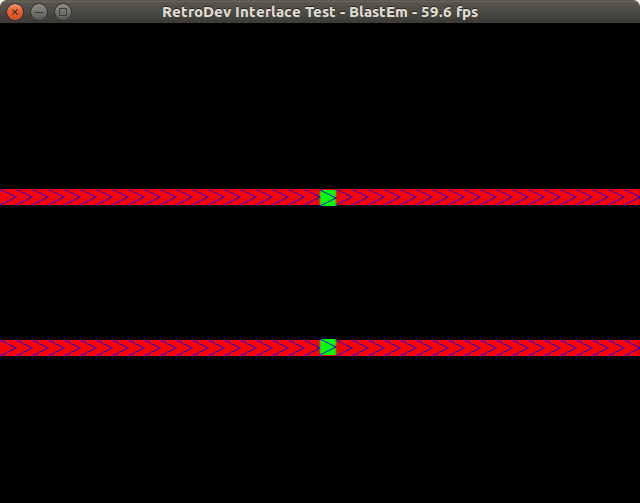

Test confirms that both vscroll and sprites use the least significant bit in double resolution interlace (LSMx=3) mode. The way it works is that a bar is displayed on Plane A with an even scroll value and a sprite is displayed at that Y+1 (well +257 due to the difference in coordinate system). Further down the same bar is displayed on Plane B with an odd scroll value and a sprite is displayed at that Y-1 (+255 technically as above). In the first case, the sprite starts 1 pixel below the bar and in the second case it's reversed. Here's what it should look like:
Note: I've included a screenshot of BlastEm rather than from hardware because my capture card is garbage, but I have confirmed that hardware behaves the same.
And here's the test ROM: Binary, Source
With some cleverness, it should be possible to make a test that makes it more obvious whether you've got it right, but I was in a bit of a hurry with this.
