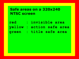

Here's the equivalent area for NTSC:
This is based on:
http://www.interactivetvweb.org/tutoria ... sign.shtml
And agrees with 8bitwizard's 256x192 for anything important.
