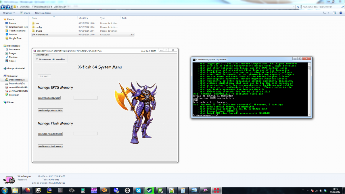

i have also made my own Flashcard with an FPGA and 8Mo Flash memory + RAMTRON for storing save
HE10 bus is here for debug and add extra stuff.
complete source and code is here :
https://code.google.com/p/xflash64/
and shematics is here:
http://sega4ever.power-heberg.com/FPGA/ ... 4_Rev0.pdf
Video First Test with Sonic 2
https://www.youtube.com/watch?v=LkB7F0W ... iA&index=4
Video 8 Mo rom test
https://www.youtube.com/watch?v=OycKK8q ... iA&index=2
and i have made a C++ Qt gui for command it ( it launch Quartus II CMD prompt with correct param)
it don't need an external programmer it works with USB-JTAG and Altera Nios 2.
when rom are flashed into memory the correct configuration is flashed into the EPCS memory for FPGA.
