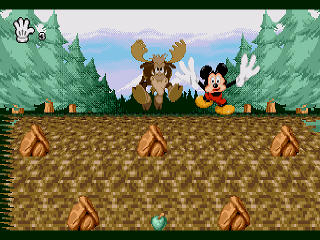

I made some tests on mickey mania "3d" levels.
Now my emulator is able to take in account mid-line display ON/OFF.
So I don't care anymore about h-blank period to redraw the line.
If I consider H-INT occurs at H-Counter = 0xA5, the display is switched off before the end of the line and i have black pixels at the right of my screen.
the delay between h-counter = 0x88 (tested in the game) and h-blank start period allows 68k to execute all instructions until switched off display.

Eke
Posts: 885
Joined: Wed Feb 28, 2007 2:57 pm
Post by Eke »
as shown by the logs, this games does not use HINT during the 3D level, it only reads Hcounter to wait for HBlank before switching off the display. It probably do not use the HBLANK flag to have a longer available period for DMA.
the writes that disabled the display is supposed to occur 68 cpu cycles after Hcount=0x88, which is 59~60 pixel counts
Now:
0x88 + (59/2) = 0xA5
this would means that HBlank (understand, start of right border) theorically start at this value (at least, we know this is the *maximal* value for HBLANK to start)
HINT is theorically meant to start 16 pixels ahead, which is approx. 0x9E.
Display ON/OFF doesn't take effect immeditely. If VDP rendering unit is 2 cells (1 column), perhaps this take effect only next column?
probably, yes.. anywya, you shouldn't count the number of pixels to render with the border color but rather the number of "column"
I know that game doesn't use horizontal interrupt but in my emulator a line begin with H-INT so i begin my h_counter table value with the value the h_counter has when H-int occurs ...
I must adjust my timings.
I make the H-INT occur at H-Counter at 0xA5 that's why i have this problem :-)
This is the hblank period which start with 0xA5 ...
My table must begin with 0x9E.
What an error ...

Does Mickey Mania does :
- Display Off
- DMA ON
- Display ON
with 1 move instruction?
The problem in my emulator's that as display ON/OFF is in the same instruction the cpu is freeze after the instruction so display is switched ON immediately and the 16 words needs 6080 MCLS (because we are in active display) instead of 536 MCLKS (no more in blanking) in order to do the transfer ...
I must correct this before continuing my tests.
- Display Off
- DMA ON
- Display ON
no, it does Display OFF/DMA ON in the first MOVE
then Display ON/DMA OFF in the next MOVE
CPU is kept out of the bus during DMA so it can't execute the 2nd MOVE until DMA has finished
and I don't even think you should care about disabling then enabling the display using a single MOVE.L (do two consecutive writes in the SAME register), this would not even be noticable on screen
no game should do that anyway (why would they do ?)

A test which can be interesting to do on real hardware is to change h-counter value tested by mickey mania.
By incrementing the value the blanking period will be visible on the left on the screen.
By decrementing the value the blanking period will be visible on the right.
It could be interesting to know min/max value h-counter can be used without visible blanking period be shown on the screen.
