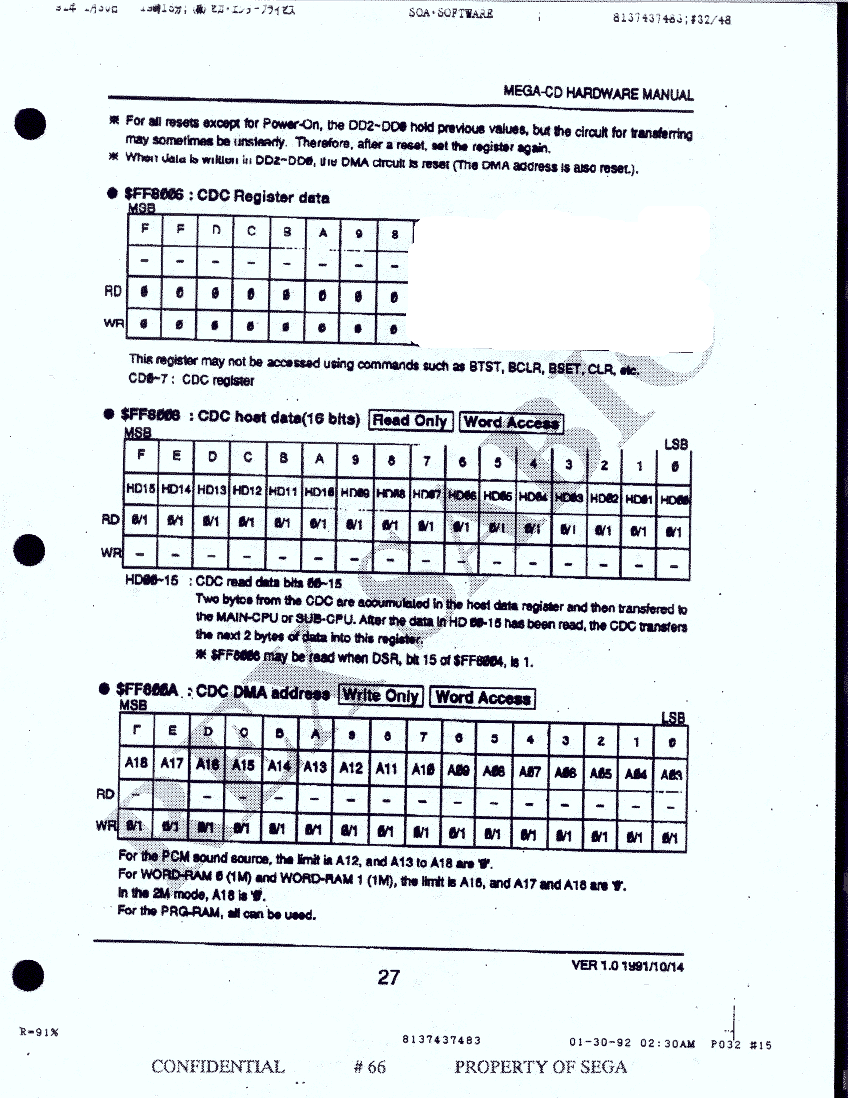

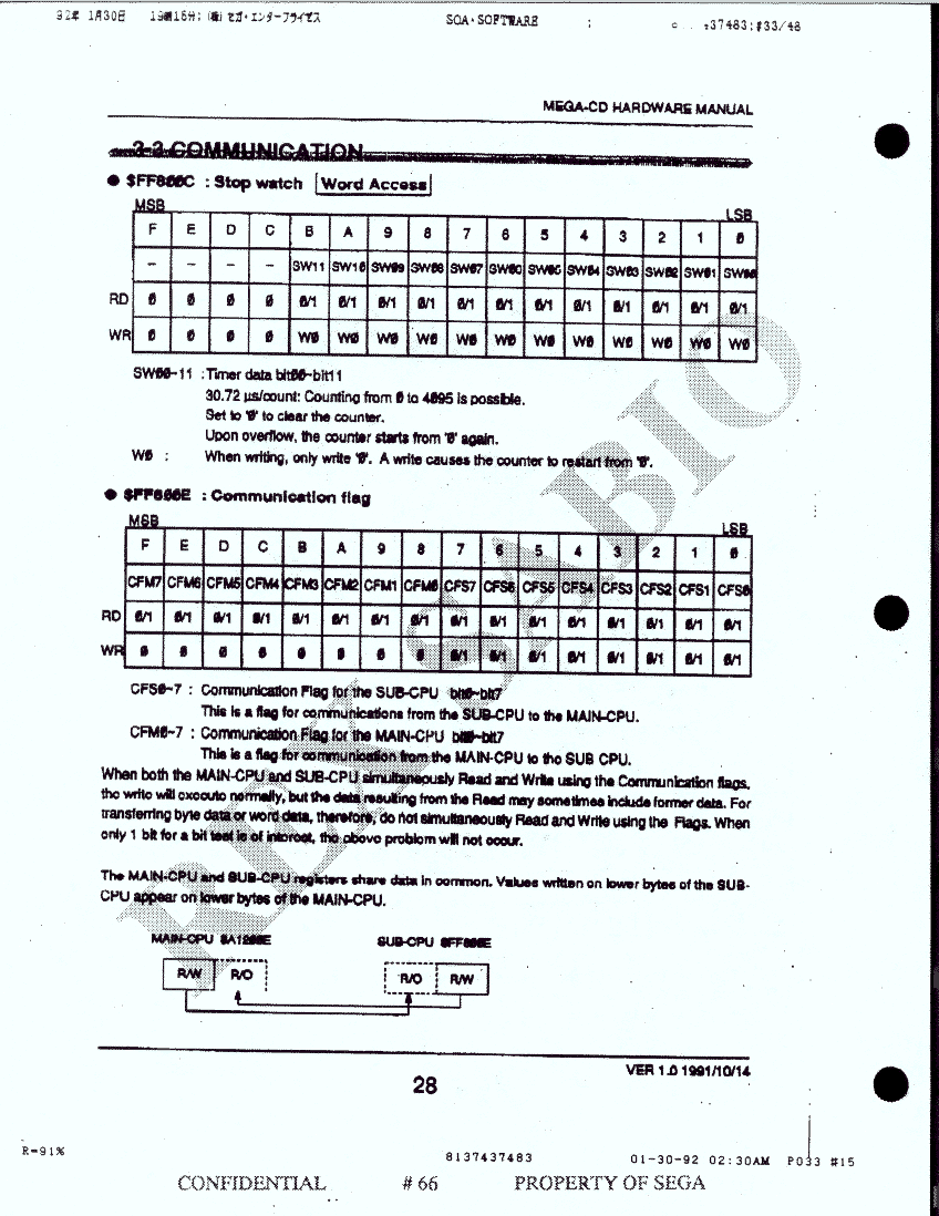

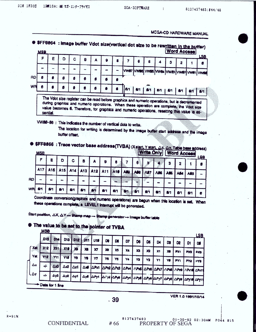

Would that apply to the RAM as well? Seems like it would
Yes, the main ASIC is handling entire sub-CPU address decoding so this apply to everything mapped in sub-CPU range (no software rely on this though)
May I ask which document/page? I'm having trouble finding it.
You have to look at registers description in the Hardware Manual (the one with greyed out parts), here are some examples with the mention "word access" (note that there is a pdf version of these manuals available online, not sure where exactly, maybe on segaretro):
https://www.megadrive.org/elbarto/megac ... Cdh-27.gif
https://www.megadrive.org/elbarto/megac ... Cdh-28.gif
https://www.megadrive.org/elbarto/megac ... Cdh-39.gif
