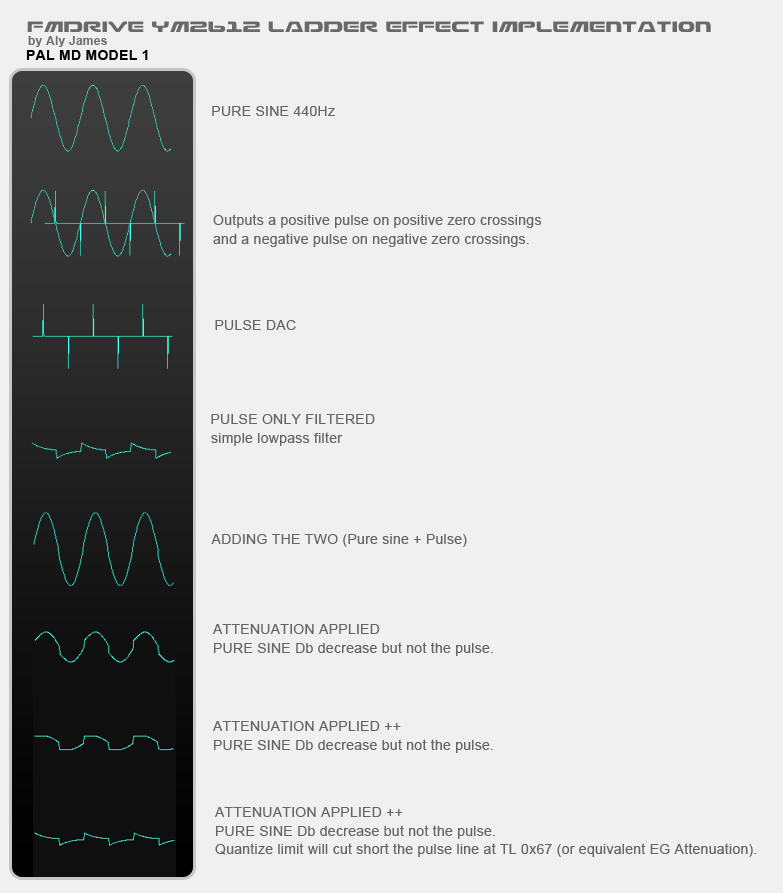

Eke wrote: and how did you implemented the characteristic DAC "distorsion" ?
Some more infos :)
This basically what gives me the best results, thinking about what could happen between MOL and MOR and the sign bit thing..and the same behavior his observed on the hardware. Here is a digital emulation.
The pulse line is masked by the clean signal when there is no attenuation (as the clean line is noticeably higher) and is almost unaffected by TL or EG attenuation. see post above.
hope that helps :)
EDIT: I Forgot to mention that I also offset the negative pulse as the attenuation increase...resulting in a change of the pulse wave duty cycle from 50/50 to almost 90/10. This reflect in the tone in the end.

Regarding the ladder effect, I will post my latest implementation on the YM2612 sticky doc :)
I finally find a way to implement this at no cpu cost..
viewtopic.php?t=386&postdays=0&postorder=asc&start=684
